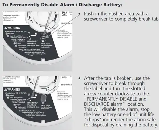

It turns out they use a photosensor to determine smoke. When the sensor gets dusty, it will produce false positive alarms. You need to clean the sensor out with compressed air. You can disconnect the alarm from power by twisting clockwise and lowering it to remove a clip to prevent more false negatives before discharging the alarm as @MTA suggests.

To permanently silence the alarm and discharge the battery, follow the instructions that came with the unit:
e
MTA
  • 15,038
