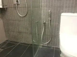

We just had our bathroom redone (including built-in tiled shower). The shower tiles are now leaking through the wall into our living area.

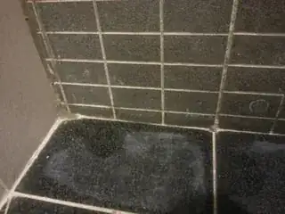

Our contractor suggested to just apply a waterproofing solution to the grout lines (especially floor/wall join where we suspect the leak to be), but I am worried this is only a temporary solution.

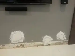

The white marks are where the contractor drilled/dug to investigate.

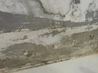

We noticed the water marks above the skirting, and when we removed it, it was soaking wet and the plaster was soft and you could dig it with your fingernail.

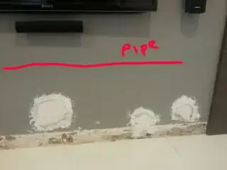

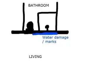

The contractor assures me it is not the pipes, as they are higher off the floor so we would see damage higher up. The damage is the worst at floor level, pretty much opposite where the shower cubicle is (and where water pools during showering, soon drains and leaves just a thin film that will evaporate)

Do you have a basement? What is under the shower?
It's a low-rise apartment (2nd floor) so it's another unit below.
Is that sheetrock or cement board? Is there any waterproof membrane (rubber, plastic or paint-on?) under the tile or board? Have you determined which side the water is coming from?
The floor (under the tiles) seems to be concrete, the wall between living and bathroom is solid but I am not sure of the material (he had drill/chisel the holes to investigate, brick or concrete or something similar). The water is coming from the bathroom, we have not used the shower in 2 days and the wall has dried up considerably.
Also: water pooling when you shower = sign of really bad contractor. At this point, I'd start over. Gut and rebuild
I maybe was unclear, it doesn't pool for long, drains in 30-60 secs until there is just a thin film of water that will evaporate.

That said, without a water barrier behind the tiles in a shower, you've got a time bomb. Even if you fix the current problem, the tiles and grout are porous and will slowly leak water into the structure of your home, causing it to rot and mold. They shouldn't leak so fast that you'd see the current problem, but they will leak. A surface water proofing will help, but it won't prevent it.
