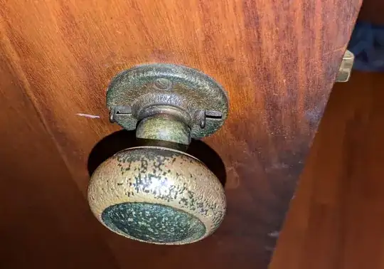

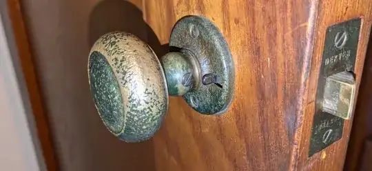

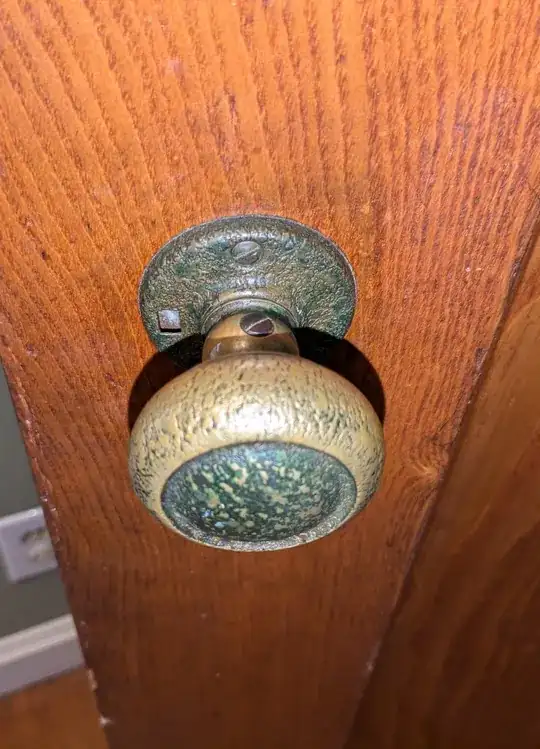

How to make the locks on these old (vintage?) spindle-style doorknobs (for bedroom doors) less stiff?
I also have a few of these wherein the lock (though I can move it all the way to the right) doesn't actually lock the door. Is there something I can do (besides replacing the entire doorknob) to get the lock to work again?
These doorknobs are from a house built around 1935.

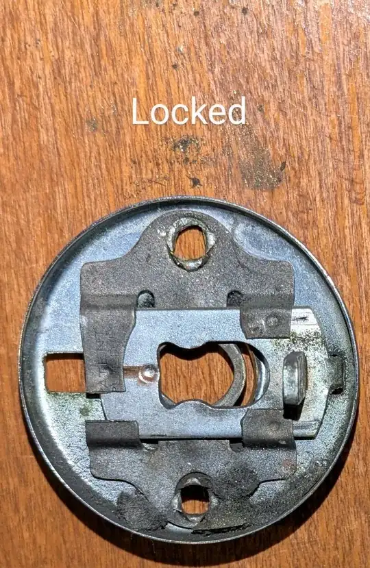

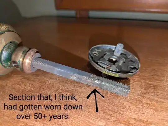

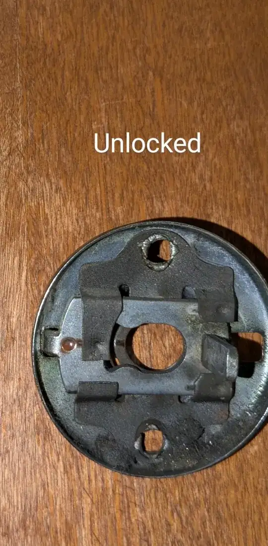

I haven't had a chance to get some graphite dry lubricant yet, but I think I figured out why at least one of the locks was no longer working. When I disassembled a different (but same type) of doorknob that wasn't locking at all, I noticed that the section of the spindle where the locking mechanism constrains the movement of the spindle had gotten very worn down (over the 50+ years of its life). So, as a quick fix, I just flipped the spindle, so the interior body / plate component (which contains the locking mechanism) would now have a (relatively) unworn section of spindle to bite into. This seems to have worked!
Here are some pics which should hopefully better illustrate what I'm talking about...
