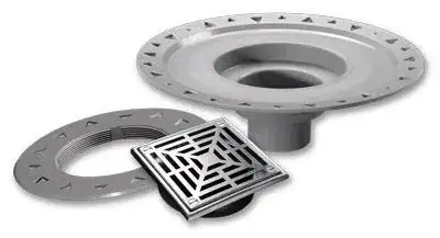

Shower pans are a critical assembly and have to be treated as a system. Both Schluter (sheet membrane Kerdi) and Laticrete (liquid membrane Hydroban) use a wide flange drain assembly that improves the transition area between membrane and drain.
