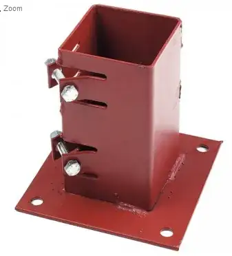

There are more options than "move it" or "break it and remove it." Check with a local rental store to see what sort of concrete saws and/or drill bits are available. You could then saw off a portion of the slab, chip out a trough for clearance for fence rails or drill out a smaller area to allow a fencepost to be inserted. It would save a lot of labor but would cost a bit for rental.
