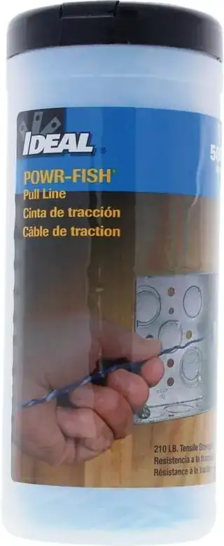

More generally useful is to add a pull string for future use through the entire conduit, such as this Ideal from Amazon:
Pull string
