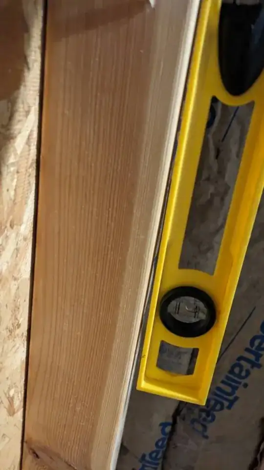

Earlier this year, I noticed some bowing happening to some of the studs on the west wall. The bowing on this wall seems to be about 1/4" and happening towards the middle of the stud. Looking at the inside of this wall, I don't notice any water damage.

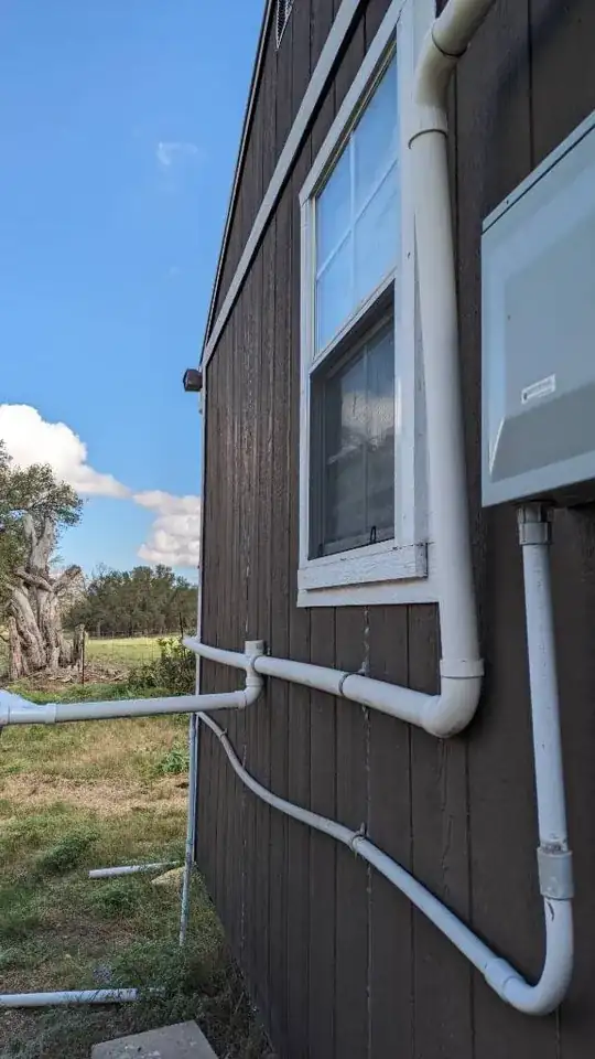

Notice the area to the left of the window and just underneath the rain catchment T.
West wall West wall interior

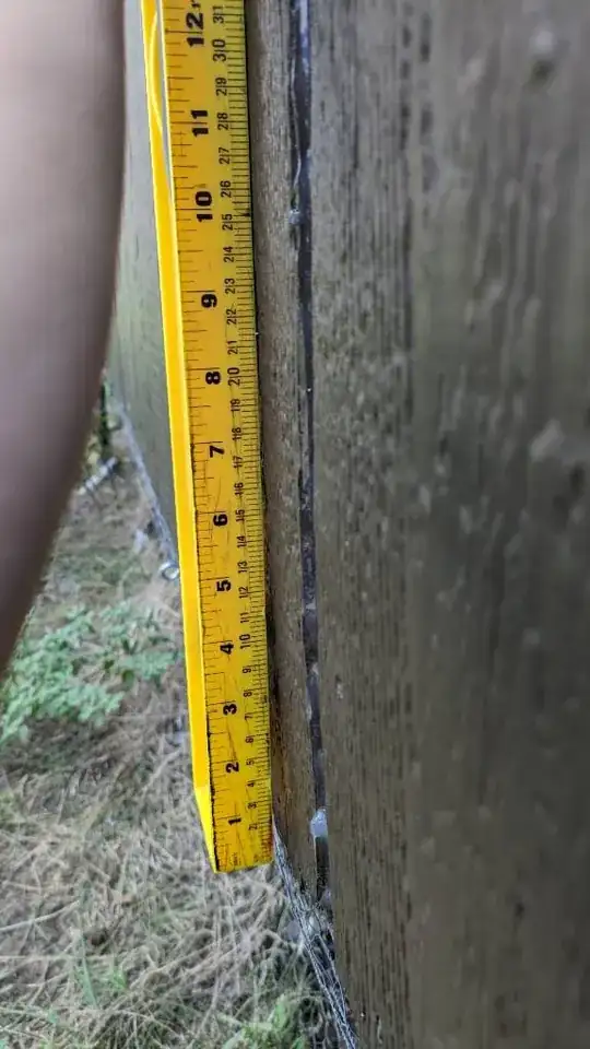

There is some bowing on the east and north walls mostly towards the bottom of the studs. There is one location where it is bowing in the middle on the north. On the west and north walls, the bowing became severe enough that the panels of the siding started to separate. I used a little clear silicone to fill the gaps. I believe the siding is LP Smartsiding (feel free to fact-check me; maybe I'm wrong).

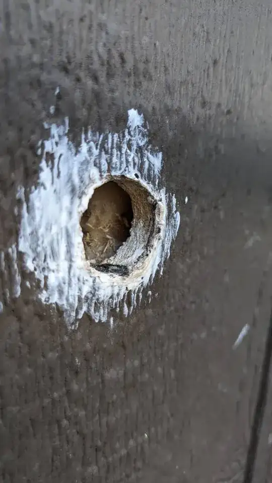

Here's a picture of the north wall as well as a hole I drilled in the south wall for something unrelated. The purpose of the hole picture is to show the experts (you) what things look like under the siding. Maybe that's just siding, maybe it's thin OSB. I don't know. This hole is under the porch and usually carries a pipe that has the edges crudely sealed with silicone, so I don't think it has any relation to the warping.
North wall Hole drilled into the south wall.

I have not noticed any cracking happening to the drywall inside. There is a rain catchment system on the west side which I (stupidly) mounted to the exterior wall. This past summer, a pipe came loose at the T junction and dumped water all down the wall. The past two or three summers have also been excessively hot. I should mention that the north side is not perfectly north, and that it does catch a great deal of direct sunlight in the afternoon.
