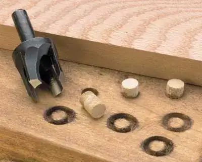

You might try a plug cutter in a drill press, used to cut face grain plugs to match the grain of the wood. Now, drill the holes out with a sharp drill bit, so the plugs will fit perfectly. A tiny dab of glue on the plug, and it is there to stay. Now you will have face grain set into face grain. If you are careful to get a nice grain alignment match, this can be made to work very well. And since you can buy plug cutters of various sizes, you can fill holes of many different sizes.
plug cutters
Once the plug is set in the hole, sand it down to be perfectly flat to the door surface. I rarely even wait for the glue to set, since it will do so in good time. Anyway, the sanding dust as I sand mixes with any glue present to fill in even any tiny imperfections around the perimeter of the hole. Note that plug cutters do not work well in a hand held drill, but you can get an attachment for many drills to make them work like a small drill press.
