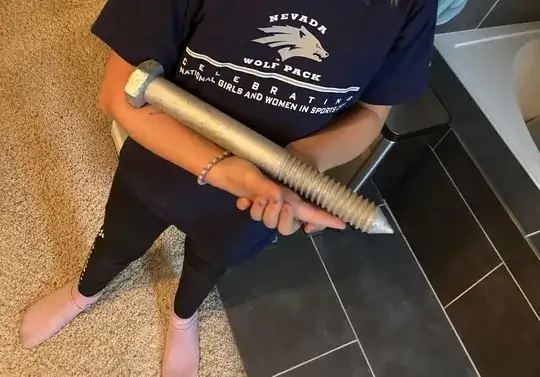

I'm just putting this here because it's freaking hilarious. Be aware though, that to properly use this absurd thing you need to pilot for the full screw shank to the depth that it'll be inserted, then beyond that slightly smaller than the shank for the full depth of the screw. Who has bits like that??
(photo: 2-inch diameter wood screw)
image source
