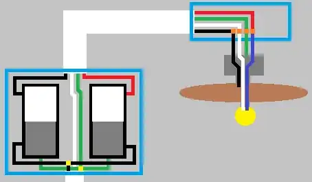

The original wiring looked something like this...
Original Wiring

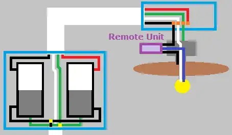

The wiring with the remote unit looks something like this...
New Wiring
As you can see in the new wiring, the remote unit controls the current to the fan and light. Because of this, the second switched ungrounded (hot) conductor is not required.
