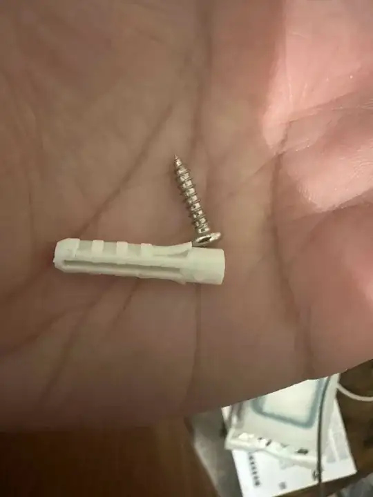

I got following screw and it’s wall anchor, I have randomly found a drill bit and made the hole is wall but that was layman guess.
How can I know which bit to use for wall anchor, and nail? nail and anchor

Pilot holes for screws is the minimum or slightly less diameter(shaft diameter without threads).
For nails about 1/2 to 3/4 nail diameter.
For anchors it should on the label on the box/bag they came in. If no label/instructions, use a slightly smaller diameter than maximum shaft size. You should need to push hard to get the anchor in fully.
