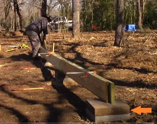

What are these concrete slabs/blocks/pads called? They look similar to a patio slab, except they're thicker and used to elevate a cabin or other building off of the ground.

Useful terms:
Caveats about use of such products:
  • Substrate must be suitable inorganic soil. Black dirt and other unstable or uncompacted soils will allow severe settling.
  • Expect to have to jack and shim after rough construction. The weight of the building will probably cause some shifting.
  • Most building codes require frost footings to a depth appropriate for your climate. This isn't something to avoid because you can. It's good practice.
User1974
  • 1,758
  • 35
In Ontario, Canada, they are often called "cottage pads," since they are most often used for cottage foundations.
