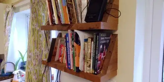

My contractor first used floating shelf brackets, drilling suitable holes in the back of the shelf. They bent. It was 10 years ago but I think the steel backplate of the bracket twisted. This is 40mm oak, so really heavy, but it would work equally well in thinner material.
Then he used brackets intended to be hidden behind the books. They were fine with the weight of the shelves, but bent when loaded (they were too flat to be stiff enough, so they'd hide better).
Finally I made these bookend brackets from offcuts. I meant to fill the holes with dowels, but decided against it.
bookend brackets on kitchen bookshelf
So no longer floating, but very effective given what I use the shelves for. All the brackets used were screwed into the concrete blocks forming the inner skin of the wall, passing through plasterboard (drywall) and a small air gap on the way
