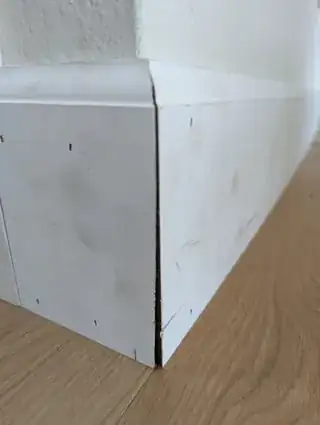

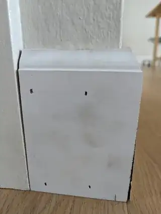

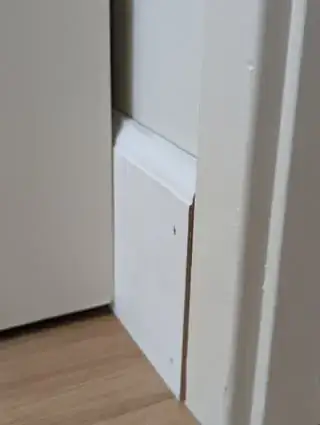

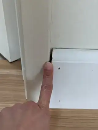

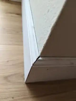

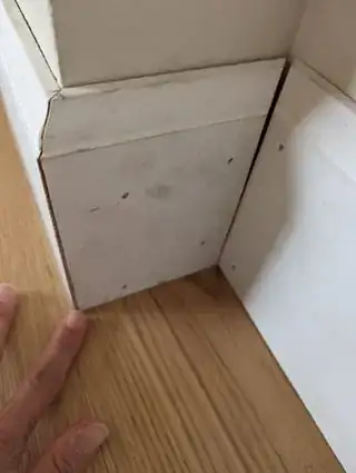

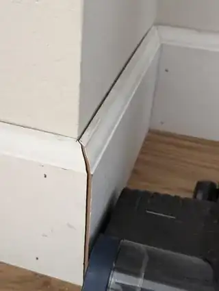

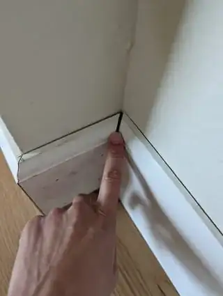

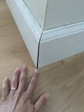

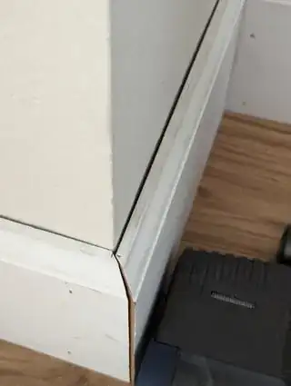

We had new baseboards installed (alongside our new floor). The result looked surprisingly rough to our eyes but we have no notion about what to expect. The installer and floor store told us that this is perfectly normal -- we just have to caulk and paint.
If anyone out here is knowledgeable about this, we would really appreciate their opinion.
Thanks!

Some contractor work success is in the eye of the beholder, but this is just plain unacceptable. This person does this for a living? The contractor works for the flooring store? If so, post reviews of the experience to warn others at least. Has the store seen these photos?

26
This wouldn't be acceptable for a DIYer let alone a professional. My guess is that his/her miter saw guide needs adjustment/cailbration or that the angles are correct but the walls are out plumb and not square. The installer should have at least done the caulking to cover the lousy job. Take some pictures and show them to the company the installer works for. Withhold final payment until they correct it.
JACK
  • 89,902
  • 214
This would be acceptable was it 13-year old building their treetop house.
  • Pieces lengths are obviously off
  • Angles are off too
  • Vertical alignment is almost non-existent
  • Uncovered nails
  • Dirty surface
Demand the rework. Warn others not to use their services.
