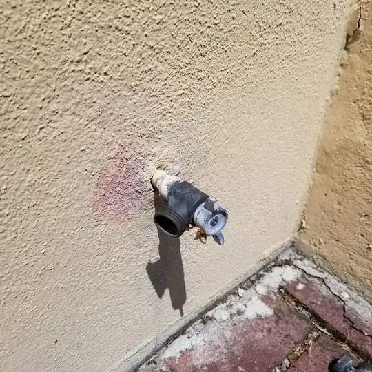

The hose bib at my parents' place hasn't been working for quite some time so I wanted to try my hand at replacing it with a frost-free sillcock. While water only dribbles out when the faucet is opened, the shut-off valve looks very corroded and I believe there's a blockage inside that is causing no flow; maybe the stem broke off inside.

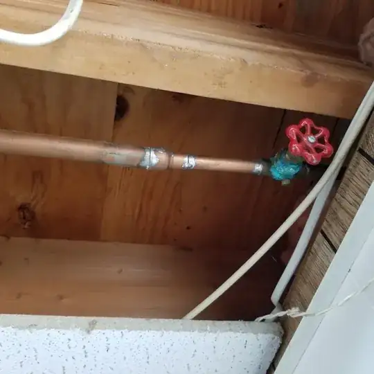

The existing line for the outdoor spigot starts as 3/4" and is reduced to 1/2" right before the shut-off. So there's about 2' of 1/2" piping between the reducer and the hose bib outside.
Outside spigot
3/4" to 1/2" reducer and corroded shut-off gate valve

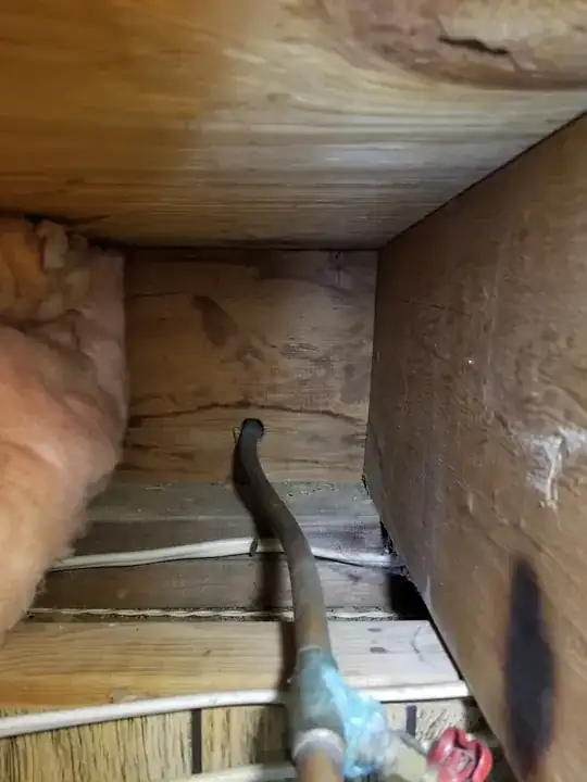

The problem is that the hole in the wall is offset about 1.75" horizontally and 0.5" vertically to the rest of the line, and it looks like when it was originally installed, the plumber had bent the pipe to make the connection. Is it feasible for me to make a bend in some hard copper (type L) I already have? I watched a few videos on annealing hard copper and thought a minor offset like this one would be okay to do. I know I could probably do it with a couple of 45-deg elbows but I would imagine the fewer couplings I need to solder, the better.
Bent pipe to accommodate connections

You haven't explained why flow rate is important. So I will ignore that since the original issue is that the outside hose bib only allows a trickle of water. You haven't said that the water pressure in the home is an issue, so I'll assume that is all ok.
The inside shutoff shows some corrosion. I would begin by replacing that. (It could be an issue if you shut off the water and then open the valve again)
Since you have a line in place that is 1/2", use it. Why make simple stuff complicated.
Replace the bib outside when you replace the shutoff inside. Now you have 2 new valves that will work properly. (If you prefer, you can instal the frostless silcock. But again, is it really needed with the inside shut off? )
This will correct the issue. If there is some reason that the flow rate of GPM out of the hose bib is important for timed irrigation, device fill or some other reason, your have not told us that. Otherwise the 1/2" hose bib will provide enough water for normal expected use.
