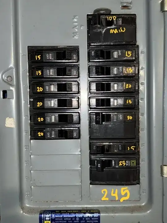

I want to change out the 30a breaker for no longer used dryer for EV charging station with 50a. I would assume if panel can handle it I would need heavier wires to outlet. Just don’t want to find out after buying an EV the charger station price jumps crazily because I would need panel/service upgrade also. Panel100a pqnel
Chet C
Yes, you can change the 30amp breaker to a 50amp breaker provided you increase the wire size appropriately. You should first do a load calculation so determine if your panel can handle the increased load. Adding up the breaker amps is not a load calculation. Google it. Most of the people I know that have chargers have ones that are much less that 50 amps and they work fine. You might find out that you can utilize your existing setup.

You never need a service upgrade to charge an EV
Because from the start, the right technology was built into them to easily charge on any service. This tech just needs to be enabled by a proper "wall unit" with sensors in your service panel. It dynamically adjusts EV charge rate so the panel cannot overload.
That is to say, if you have a 100A service, with consumer-grade equipment rated non-continuous (so 80A continuous). By chance your water heater (20A), dryer (23A) and A/C (20A) all happen to cycle on at once by dumb luck. So that's 63A of non-EV load. So your EV immediately adjusts to 17A charge rate. When the water heater clicks off, it rises back to 37A. Etc. Yes, cars can do that - it's been in the J1772 standard since at least 2001.
