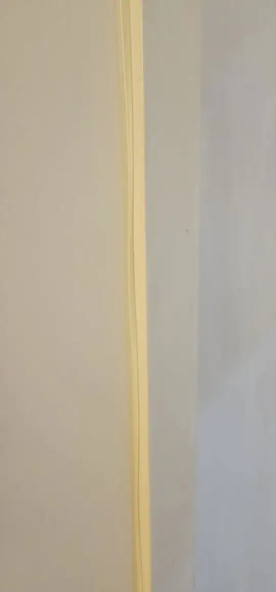

I have fiber optic cable (white plastic, about 1mm in diameter) running into my unit, installed by the provider. This terminated in a reel of cable (about an extra 30m). I decided to move the ONT, which is working fine, but I am not sure of the best way to stick the cable to the wall. I have looked at the bit installed by the provider, but I cannot tell how it was done. Is it painted in? Glued? Tape? I imagine there must be a standard way of doing this.

When my provider installed my fiber optic cable, they simply ran a small bead of clear silicone caulk along the route and then pressed the cable into the caulk bead. They had rounded inside corners and avoided outside corners because the cable could not be bent that sharp.
