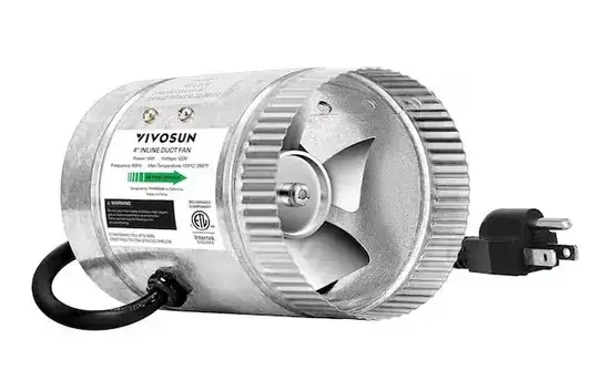

What I would do: first, make another hole in the cavity that you want to ventilate, preferably on the opposite side from the existing hole. I don't know what your bathroom looks like, so I can't tell you where to put it, but you definitely need a second hole for cross-ventilation - you want air to be able to enter through one hole and exit out the other. Then get a cheap inline exhaust fan and set it up to blow into one of the holes. Unlike a shop vac, these fans are actually intended for continuous running.
Setting up a dehumidifier in the bathroom should speed up the drying.
Moisture-absorbing materials won't help. You want to remove the moisture, not soak it up.
exhaust fan
