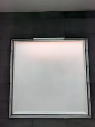

Due to a leak, a horizontal tile from the top of our bathroom window fell. Here's a shot of the window from the inside with the missing tile at top center for context.
The leak seems to be fixed so I'm reattaching the tile. Would anyone be able to answer the following questions for me?

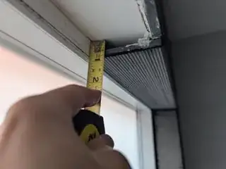

  2. Looking at the adjacent tiles that are still attached, the gap between sill and window is 1/2". Can the adhesive safely fill a gap that large?

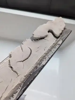

  3. The fallen tile has most of the adhesive on it. Any ideas on how to remove it aside from gently going at it with a screwdriver and hammer?

It looks as if the tile was placed with drywall compound. That was wrong.
Modified thinset should be used to reinstall the tile. Get thinset made for large format tiles. It is formulated to be applied thick.
An option is to attach a 1/4 inch thick piece of cement board with approved screws. Then you don't need the thinset to be so thick.
Mastic is only good for a thin application 1/8 inch or so.
