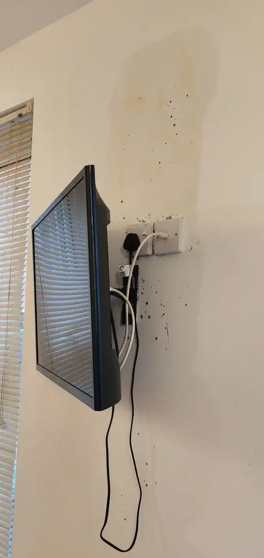

Here is the image from the ground floor kitchen. This patch appears on wall between the two windows in the kitchen:

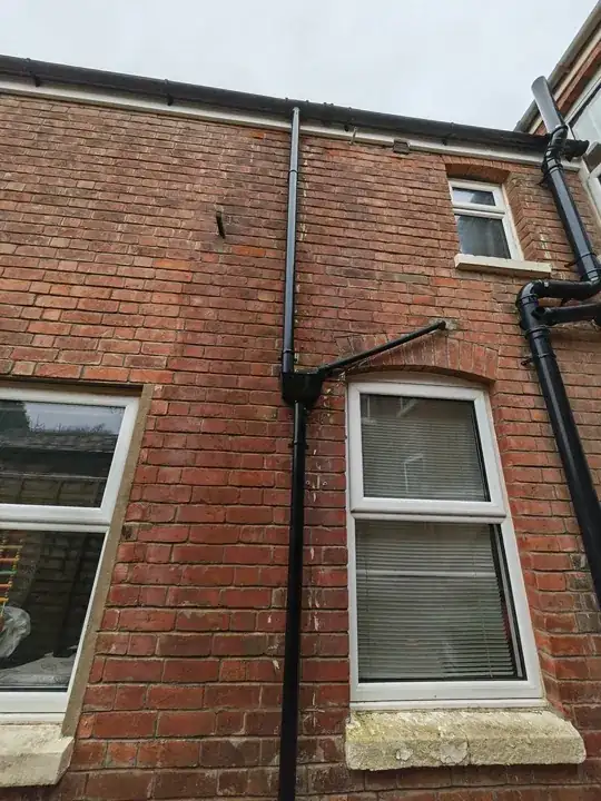

Here is what is on the other side of the wall. Please note that the black gutter and the black pipes are all newly installed around 6 months ago. This meant lot of new holes being drilled into the bricks. However, no wet patch appeared on the inside until now. Rain is common in the UK so I am not sure what is the actual reason for them appearing now.
Now similar but smaller patches are appearing on the first floor bedroom as well.
This is a circa 1900 semidetatched house in the UK. The patches appeared suddenly few weeks ago during very severe rain and have not gone away since. Overtime it has become more dark and has this yellow patches within it. I am not sure what I am supposed to do. Do I wait or do I call someone to have a look. If I call someone then who would that be.

It is evident that water has infiltrated the wall. It has not manifested itself until recently because it took some time to leach into the wall cavity. This can come from any or all of the drilled holes or possibly through the mortar between bricks. There may be cracked bricks as well. An examination is needed to determine the entry points.
The exterior need to be sealed and waterproofed.
The interior is showing the result of water. The black spots are mold. You will need to have the wall opened and any damp insulation and any other materials removed and the framing given time to dry out. When it is confirmed that there is no longer a moisture issue the wall can be closed.
Find a professional in your area that builds or renews exteriors. Or a general contractor as we have in the US. If you are not in charge of maintaining the building, alert the building manager.

The new gutter installation is faulty, or clogged; any what way, there is a major leak on top that lets water flow down the wall. Looking at the damage, it is possible that it also comes onto the top or even down the inside of the brick wall. That a lot of water flows where it shouldn't is evident by the dark patch on the exterior wall running all the way from the gutter to the bottom of the image. That is the root cause and needs to be fixed asap because, as is obvious, the water seeps through into the interior, ruining interior walling and decoration and causing a mold issue. Over time, it also compromises the wall structure.

  1. Black dots are mould.
  2. Yellow spots are caused by water "dragging" material from the wall as it flows
I would suspect the new pipes and gutter. Not because of the new holes, but for leakage. It may have clogged during the heavy rain and soaked the wall. All in all, your case suggests poor installation or failure short after - get the pipes and gutters inspected, serviced or redone (covered by the one who installed the current ones).
Then you can start thinking of drying the wall, cleaning the moss and painting the wall.

The gutter is likely clogged at the top there and is causing a diversion of water into vulnerable spots.
Address the water infiltration issue first; start with a gutter cleaning.

As for the actually problem, the obvious guess to me is the pipe installers have crossed the cavity. In UK homes you have effectively 2 walls next to each other. If someone has screwed a long screw spanning the cavity, then water on the outer wall will get to the inner wall and hence your problem. If they dropped debris down the cavity, again it would cause the same problem.
As others have suggested, there may be a blockage in the pipe which will make the outer wall wet as water saturates the outer wall, but again, unless the cavity is crossed with a screw or debris, I do not think you would get a problem as bad.
Maybe debris was already in the cavity, but a blocked pipe with water overflow is only showing it now.
As others have suggested, see what happens on the outside when it is chucking it down. See if there is an obvious water overflow.

A 1900 house almost certainly has not got a cavity wall.
The narrow pipe is an overflow pipe from the cold water tank and provided that this is not dripping in dry weather, this is not a problem.
The damp appears to originate from where the vertical pipe joins the gutter, so it seems likely that you have a blockage at this point.
