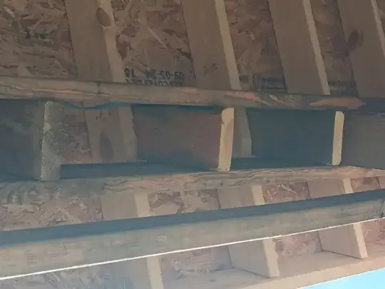

The last time I was working professional in framing, about 2017, I definitely installed these metal strips. I remember they were meant to be applied on the inside of the wall from the top plates to the rafter. That said I will emphasize I did not use walls but posts with purlins, and put a 2x10 as an outside wall header that the rafters are sitting on. Then I also have an inside header and a 2x6 block nailed between both headers then to the rafter. This, in my opinion, provides far superior protection against wall expansion and load (or uplift) forces. front wall headers and rafter blocks
I was also under the belief that as I am using a beam in the center (the rafters are resting on top of the headers) and not butted to a ridge board (which in the scenario of a ridge board separation can occur), that collar ties are not necessary. As with the outer walls, I also used blocking for connecting the rafters to the headers/beam. center post and beams with blocks
