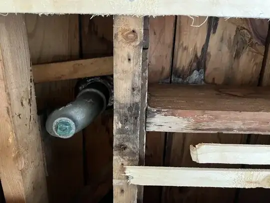

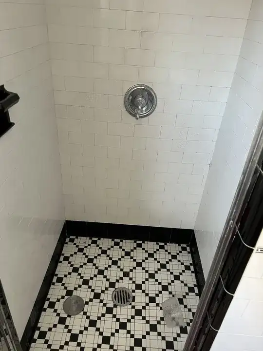

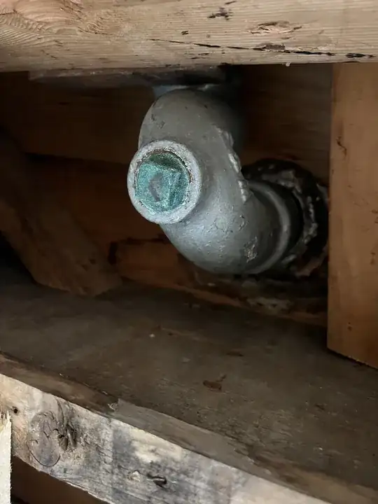

About two years ago I noticed one of my showers was leaking. I didn't have the wherewithal to fix it at the time so l just shut down the shower. I opened up the ceiling recently to finally deal with this project, called a plumber in... and it's not leaking anymore. Pipe looks fine. There are some old wet spots from these photos. I ran the shower awhile, nothing. Threw buckets of water at the shower walls, got my jeans soaked but no leaks.
Plumber says maybe just a caulk/grout issue on the sides that only comes up occasionally. I was planning to close the ceiling while leaving an access panel in case I need to go back in and continue to monitor it. But curious, based on this story and the photos, if there's something else I can do to check for leak source before I put drywall back.shower that is source of leak
plumbing underneath

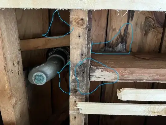

There look like water stains in the blue circled areas:
water stains on OP's under-shower picture
Maybe the tile floor or where the floor drain joins the tile floor is leaking?

There is some corrosion and oxidation on the trap plug so that might have been the leak and the rust/corrosion could loosen up in time. It's a great idea to install the access panel to continue to monitor this. I'd use the shower for awhile before adding drywall since leaks never happen the way we plan them.
