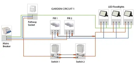

I have a pathway through the garden to get to my gate which i want ot illuminate with 3 floodlights. Its not certain that PIR sensors alone will work so I want to be able to override them by switching on the lights EITHER at the gate OR at the front door, but otherwise have the PIR sensors work as usual. I have watched every youtube video and tutorial and I think this is correct however I'm not sure about whether there is a dangerous loopback in this circuit. Can I loopback the earth like this and can I wire multiple PIRs and switches together all in parallel like this (European colouring below)
Circuit diagram
enter image description here EDIT: added the specsheet install details from sensors below

Yeah, that looks fine. You have to watch your cable routing to make sure you don't have imbalance current in any cable. I.e. currents must be equal/opposite in any given cable and a clamp ammeter around any cable must read 0 due to mutual cancel-out.

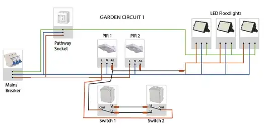

If I was making a wiring diagram it would look like this. Omitted for clarity: protective earth/ground.

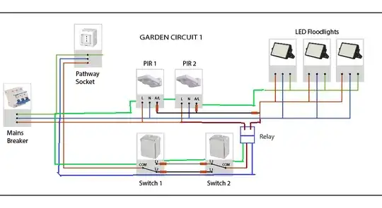

I am assuming the PIR sensors are line voltage and not low voltage. The problem with your proposed wiring circuit is that the hot and neutral for a circuit must travel in the same cable. However your power coming from the switches is returning on a neutral on a different cable which is against code.
The only way I can think of to fix this is to add a relay switch which would isolate the two circuits and ensure balanced power in all cables. Also the grounds should also be in the same cables so I updated your diagram to add the relay switch and the proper placement of neutrals and grounds
