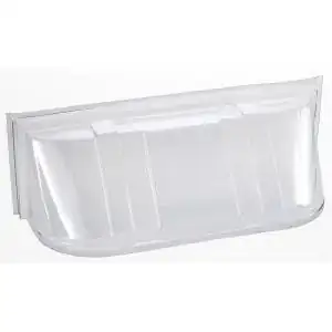

You may also consider window well covers
window well covers
They come in a variety of shapes and sizes and divert the bulk of precipitation away from the well and about 2 feet away from the foundation - often enough to avoid seepage.
P.S. They also are a safety feature, reducing the risk of kids/pets falling into the wells.

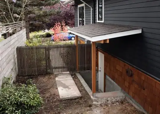

Addendum:
Since this is the high open side of the house, extreme eaves might help and might look quite cool, but might introduce structural issues in the case of high winds.
What do you think of this kind of solution?: enter image description here
Of course it should extend well beyond the window wells and by putting it somewhat high, you could balance the amount of light between summer and winter, so that high summer sun puts the windows in shade and low winter sun streams right in.
