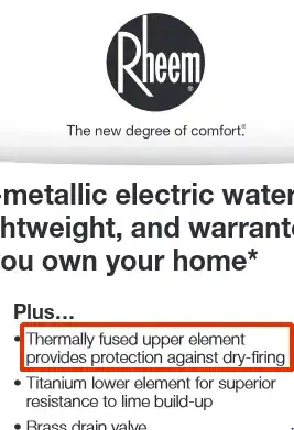

Not "resistored" but "fused". The Rheem product literature for that model says that the upper element is thermally fused to prevent damage from dry firing.
e
A thermal fuse does not change the resistance reading of the element at all until the fuse opens due to excessive temperature; then it reads infinite resistance -- though in the real world maybe 450Kohms is close enough to infinity to be the equivalent.
You should look for a thermal fuse associated with the upper element, since it's inexpensive and replaceable. If you don't know what to look for, you can take a photo and add it to your question.
