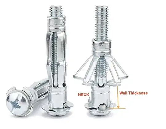

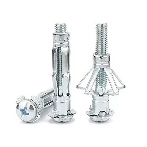

If you find that the wall of the tub at your location is too thin to hold a screw firmly, consider expanding anchors such as these. They effectively clamp to the tub skin and become reusable. Be sure to find the right length for your application or they won't work.
expanding metal hollow wall anchor
image source
Those are good anchors
but you have to choose the right one
They work based on wall thickness
The Neck shows it for what wall thickness are they made for
neck
