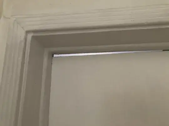

The center of my house has door alignment issues. Every few years they get out a bit more, so I plane them. It got me thinking of fixing it for good underneath the house. This house was built in 1946 and I've owned it since 2000. The degradation is slow, but has occurred over 24 years. This is in Los Angeles, so there's no frost issues. The ground is clay soil. It's on flat ground, not a hillside. It's a 1-story house with a crawlspace on dirt.

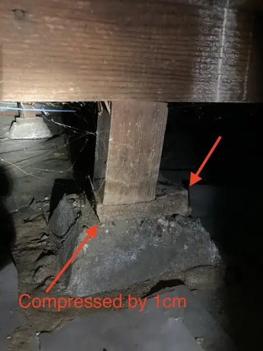

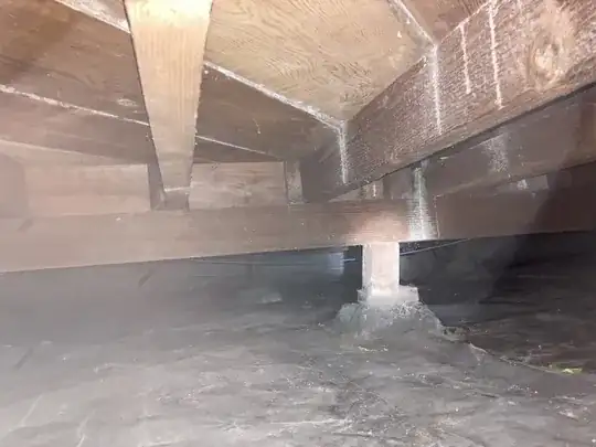

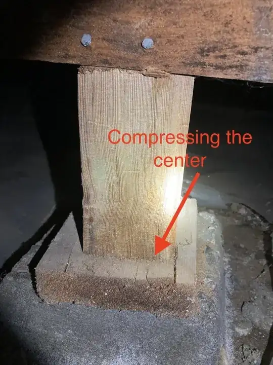

As you can see in the pics, the support beams in the center of the house start with a concrete pier, then a piece of 2" as the base, then a piece of 4"x4" supporting the joist. The problem seems to be the 2" base--they are compressing from the weight. One of them is compressed by about 1cm. It's harder to tell with the other because the compression is happening in the center of the wood, but you can tell it's compressing too because you can see the wood around it cracking and lifting.

If your concern is being able to return the jacks if you don't need them, start by replacing the crushed block with new lumber. See if that helps. That might be all it takes. (It's rare to see crush like that--there must've been microbial decay over the years, or that's just a soft species of wood.)
