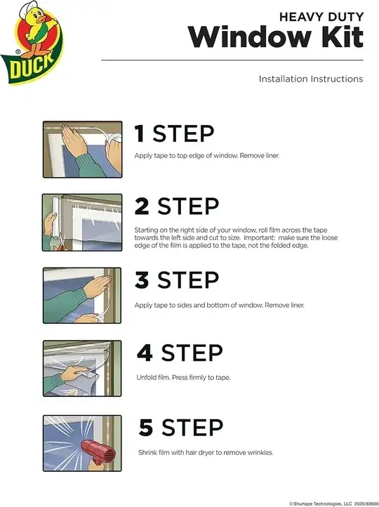

  • If you can spend just a little bit more, consider getting a window insulation kit like this one from Amazon:
Window insulation kit
The details vary. Some have thicker plastic than others. They have different types of tape for the edges. But the premise is generally:
  • Clear plastic to cover the windows, so you can still get natural light
  • Something to hold the plastic at the edges
  • Use a hair dryer (a heat gun might be better, but the average homeowner has a hair dryer and these are designed for easy DIY installation with no special tools) to "heat shrink" to hold the plastic really tight
The idea of "dead air between plastic and windows" is exactly the same with taping up plastic bags. But these kits do a much better (and more attractive) job of it.

Let the light reach more of your room for more benefit and greater comfort. Use clear plastic on your windows to block air leaks (by far a more significant benefit) and provide some level of insulation value while still allowing light transmission. Window kits exist for a reason and aren't terribly expensive. They allow you to tighten the film so it's nearly transparent.
