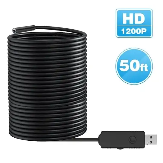

If you don't need a semi-rigid cable, Teslong makes an inexpensive USB borescope with a 50' cable ($28). I've used this with my laptop to examine my HVAC system, and it is apparently compatible with most smartphones (although I haven't had any luck finding a USB adapter that fits my Google Pixel).
Teslong 1200P 50' USB borescope
