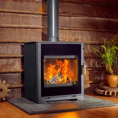

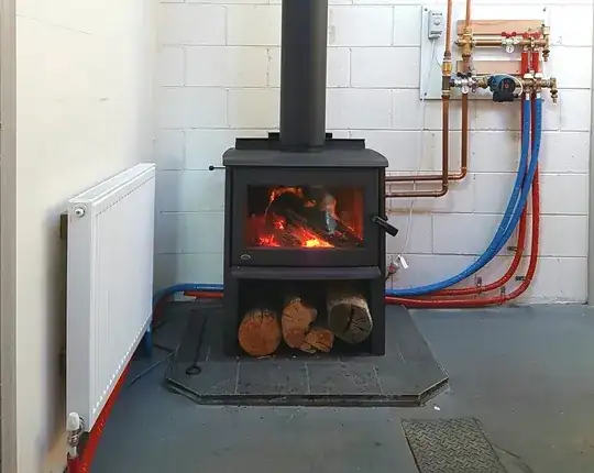

The UK and Australia there's such a thing as 'back boiler', which is a wood stove that also includes pipes for heating water, and is located in your living space. Showroom example:
Back boiler (source)
I had to look hard for a picture showing the pipes, because on most of them they look just like a normal living room wood stove but with an extra compartment at the rear, example:
stove
Examples might be in the 15-30kW range. Aside from having to tend to the fire in order to get hot water, there are two downsides. One is that the relatively cool water causes more condensation of tars at the heat exchangers. The other comes with older back boilers which were often built into fireplaces and abandoned. If there is a small amount of water in the heat exchanger it can boil to steam and then explode - you would need some way to avoid this with some kind of over temperature alarm. Also you need to make sure you never heat the water above a safe maximum temperature (~60C) to avoid scalding.
I'd not want to rely on one for full time hot water heating (firing and cleaning any stove is manual work), but they can be a useful contribution if you have free wood, a large hot water demand or habitually run the fire anyway.
