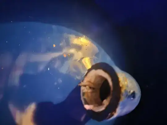

The PVC pipe threaded into to my pressure tank broke off at the threads. The tank has no water in it, and I need to release all the pressure out first.
How can I remove the piece of pipe still in the tank opening? Can I heat it with a torch?

You appear to have already cut or melted a slot in the broken pipe stub.
Insert a screwdriver and twist in the slot to bend part of the broken pipe away from the iron female threads. Bend until it either breaks off, or you can grab it and pull it out.
Bending the "upper" side in this picture away will make removal by rotating what's left counterclockwise easier, as you'll be pulling rather than pushing what's left of the plastic pipe fitting. Once you have a little space you can also slip additional tools in from the end to pry the plastic away from the iron.
