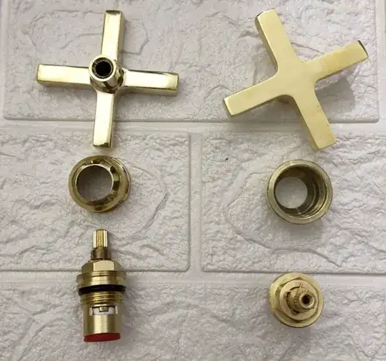

I'm trying to put together the parts for simple hot/cold brass valves for an outdoor shower. I found these cross handles that seem to have a 1/2" cartridge - however I'm not sure if there's a universal valve body to put them in.

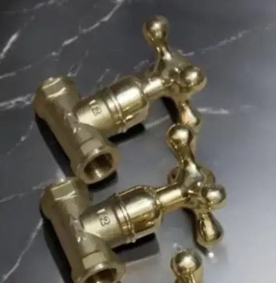

Basically I want to make something like this tee with the valve coming out of the top (an elbow config instead of a tee would also probably work), I am assuming its not as simple as buying a brass tee for this haha?

Universal valve body - not on this planet, or in this universe. If you "found the parts" somewhere with part numbers that should lead to what valve bodies they fit. Whether those valve bodies are made anymore is not guaranteed, however. Replacement parts continue for some years after the entire valve is discontinued, normally.
The parts in the second picture are valve bodies, not tees.
