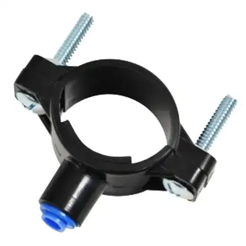

It is called "Drain Saddle Connection" with 1/4" Quick Connect
saddle
Found here and other places
drain
