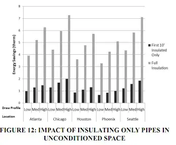

Maguire, Fang, and Krarti have developed a simulation model to estimate the energy losses for prototypical domestic hot-water distribution systems. As an example application of their model, they assessed the impact of insulating pipes in unconditioned space (Figure 12):
Figure 12
When they combined this with estimates for the cost of insulating the pipes, they found that “In the most cost effective case of adding ½ in. (12.7 mm) insulation to the distribution system of a high use home in Atlanta, the simple payback is estimated to be 26 years. Adding insulation to just the section of piping in unconditioned space appeared much more cost effective, with simple paybacks less than 10 years possible for homes in colder climates.”
Note: This paper assumes the price of 3/4" insulation to be $3.30/ft. 1" insulation can be had for about $0.45/ft currently (Jan 2021), about 7x cheaper, thus reducing the payback period drastically.
