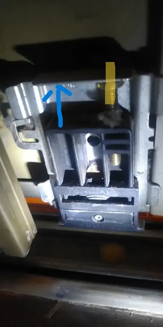

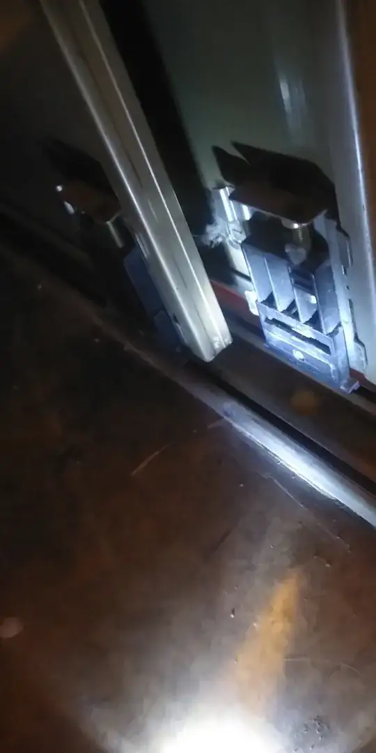

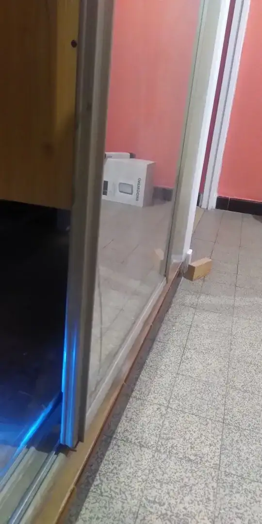

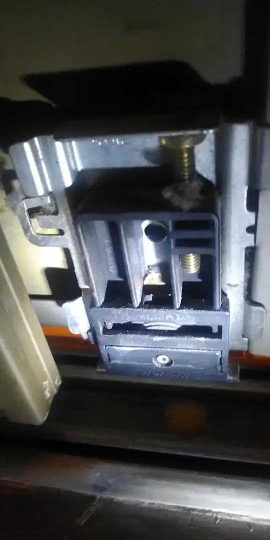

I have a closet with 2 old sliding panels and I want to remove them. The wheel is at the bottom and I found how to unclip the panel at the top.
My problem is that I can't figure out how to unclip the panels at the bottom. The plastic thing holding the wheel is attached to the panel and I don't think I can separate the two of them. The screw is only there to adjust the height of the panel.
However I don't see how else I can unclip the panel at the bottom.
I looked at tutorials, often telling to just wiggle it out by pushing up but didn't work for me. Not sure if it's because it's not the solution here or if I didn't put enough force.
Anyone have ideas on how to solve this?

You should be able to turn the screw in the bottom truck or carrier (marked in yellow) and move the truck up. Move it far enough up that you can lift the panel out of the lower track and then remove the top from the track.
