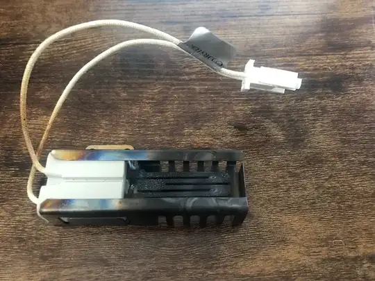

Here is the igniter in question. It consists of a (black) metal cage holding a ceramic block that holds the (black) heater element.
Samsung stove igniter
Note that the broiler uses a separate igniter (but of the same type). However, from videos I have seen you need to pull a lot off the back of the stove in order to access it. The sad part is that the broiler igniter will fail in the same manner, and that I'm probably going to have to replace it sometime in the future as well.
