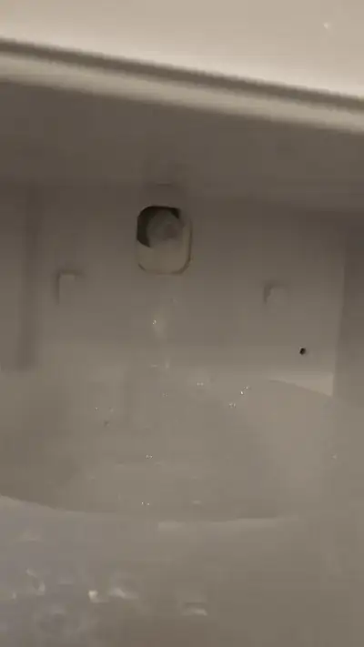

The ice maker in my GE refrigerator (model number DFE28JSKFSS) has been having issues with ice accumulation in and arround the ice bin. I have narrowed this down to the fill tube spraying water erratically and causing splashing water throughout the ice bin.
ice maker fill tube
I tried replacing the valve, but that didn't help. I was thinking maybe an issue with the fill tube heater causing the fill tube to freeze, but I put a fair amount of water through the fill tube using the diagnostic mode, I figure that would have cleared out any ice buildup, but the flow didn't change at all.
Anything else I should check? The only other thing I can think of is a partial clog or some other issue with the fill tube, but the fill tube doesn't seem to be serviceable on this model.
