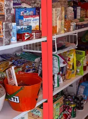

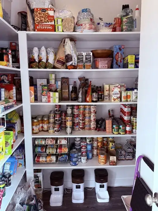

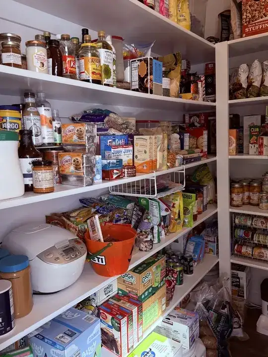

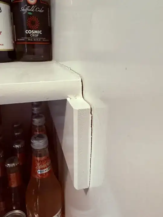

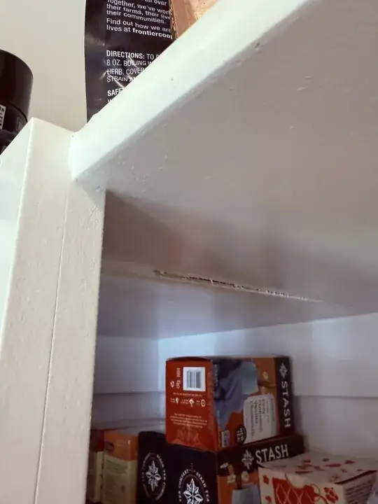

I have this well stocked pantry and have noticed a little bowing toward the center of the shelves. I’m worried that they may eventually collapse. Is this something to be worried about, or is this fine? If they need to be reinforced, what would be the best way to do it? I have a ton of tools, but am fairly light on DIY experience.
whole pantry whole pantry roughly half inch of sagging seen in paint paint separation between shelves paint separation on wall how all shelves are attached to the wall

This is not THAT bad. Ya, it's bad. It could have been made with thicker shelves and constructed a little better. Rebuilding it would be rewarding but probably a waste of money. You can improve this significantly for about $20.

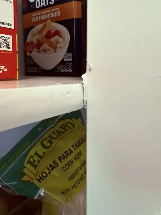

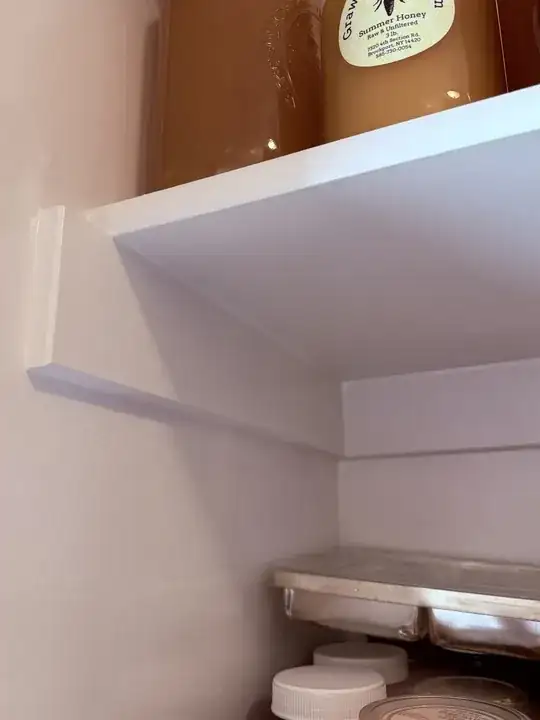

  1. In one of your photos, the ledger board is peeling away from the wall. You have tools? Use your stud finder (or buy one) to find all the studs, and put a #8x2" coarse thread screw into some critical studs -- wherever you see weak points, near the ends and middle of each board, etc. The more the merrier but you don't have to go crazy because they generally seem to be holding.
  2. Buy another piece of 1x4 or whatever that one leg is made of to create another leg in the middle of the long shelf. (Or buy white composite or white melamine so you don't have to paint it if you're not too fussy about color matching). Cut 3/4 inch notches to support the shelves from underneath. A few screws hold the new leg in place but do not support the shelves.

The second-to-last picture makes it look like the boards (1x4 maybe) are pulling out from the wall. In my house someone made shelves like this by hammering finish nails into sheetrock. That will collapse for sure! If you have a studfinder you could start by driving screws through those boards (the ones flat on the wall) into studs.

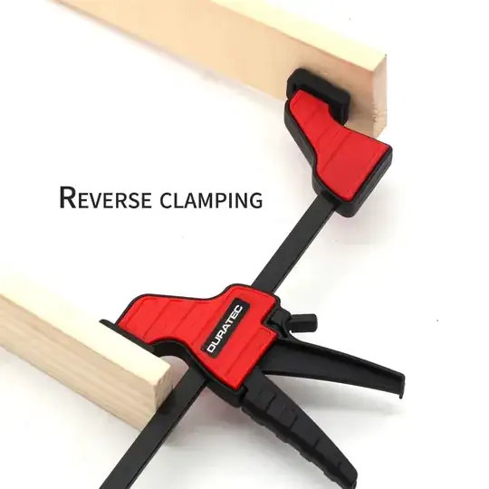

You may need to jack up the shelf to take out bowing/sagging while the glue sets, so some of those reversible clamps can be handy here. Start from the bottom shelf and progress upward

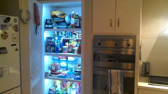

The lighting looks good in your photos - if it wasn't I'd be tempted to make the battens hang down about 10-15mm below the shelf, and install some low-voltage LED strips into the shaded area to help illuminate the dark back corners. I did this in my pantry, wired to a door switch and it make the world of difference.
An illuminated pantry with LED strips
Not mine - source: https://dondraper.com/2024/05/add-light-to-a-dark-pantry-with-led-strip-lighting/
