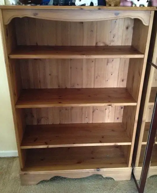

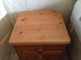

I've recently bought some pine furniture which is well built and solid but needs a bit of TLC.
It is also finished with something that gives it a kind of 'orangey' colour. It has some scratches and I much prefer the more natural, paler colour underneath. So I want to remove the finish.
My question is thus three-fold I guess:
  1. What do you think the varnish/lacquer/coating is?
  2. Can I remove it and if so, how?
  3. What would you recommend as a natural coating to protect it but keep the 'natural' colour of the wood?
Actually, 'Pumpkin pine' IS (or can be) a natural, aged color of pine.
Painting is the easiest recourse.
Formby's or similar 'refinisher' will strip wood (of varnishes) and leave some patina, after which, a wood bleach (an oxalic acid based, like Savogran wood bleach) would be called for.
Then, sand and coat with a u/v blocking clear finish.
Repeat in 20 years.
OR
Tell every one its an antique and mustn't be tampered with. Its the best TLC this beauty deserves.
