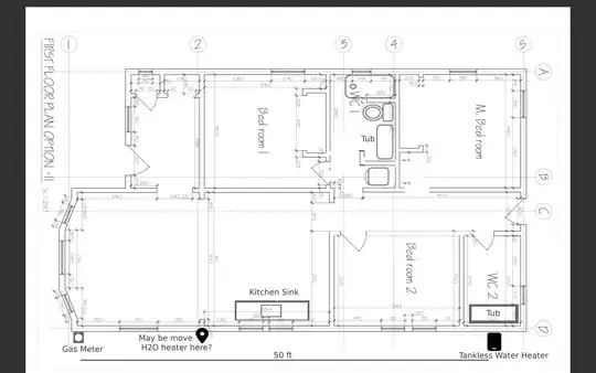

We are trying to get hot water for a 3 bed, 2 bathroom, 1200 sq ft house. I need the hot water for the two bathrooms, the kitchen, dishwasher and laundry washer.
I wanted to install an exterior tankless water heater that is about 50 ft away from the gas meter. The existing pipe size is 3/4 inches. The tankless water heater that I was looking to install is a high efficiency 199K BTU non-condensing Rinnai that has 9.8GPM. I have one furnace (space heater) and standard size stove that also use gas. The furnace is a 60K BTU GoodMan and the stove is GE with each 4 burners about 9K BTU.
Is it feasible to install that tankless gas water heater?

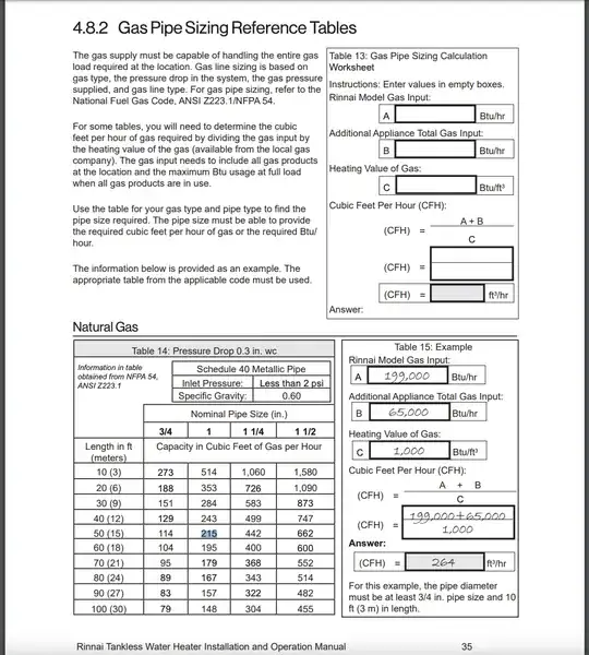

This typical chart shows 50 feet 3/4" = 151 kBTU (technically cubic feet but, subject to a bunch of variables, basically 1 cubic foot = 1,000 BTU).
There are some other factors as well which could make things worse. If all of your usage (200 kBTU (the 199 game is simply because once you hit 200 the rules change, so that's why everyone maxes out at 199, so round it to keep things simple) + 60 kBTU + 36 kBTU) - call it 300,000 BTU as a nice round number. That needs a bit more than 1" (so 1-1/4") at 50 feet.
In any case, it doesn't look like 3/4" can properly supply even the tankless, not counting the furnace and stove. It is likely, but not guaranteed, that your overall service can handle 300 kBTU, but it is critical to check that before you start on any new pipe installation.
But seriously, this is similar to the problem of large electric tankless - the demand is HUGE. Unless you truly need unlimited supply, tank is the way to go. Two tanks if you need to - typical is 30,000 to 40,000 BTU each.

Given there are no doors on this side of the house it looks like an easy solution: run a new length of 1" pipe outdoors, dedicated for use by the water heater, from the gas meter to the desired heater location anywhere on that side of the house. Front, rear, or middle -- all are doable.
