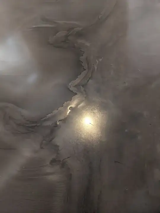

1) There are ridges from the pour. You can tell where a bucket of material was dumped and it failed to feather itself out. There are ridges like this all over the house. enter image description here

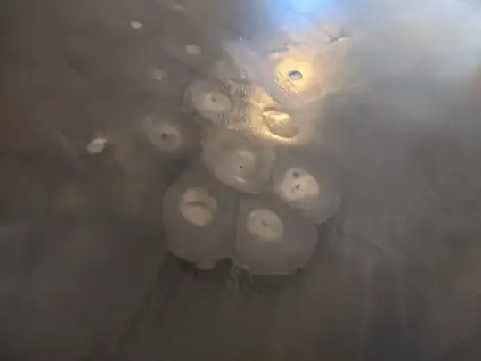

2) There appear to be footprints embedded in the epoxy. It looks like someone was walking around in cleats in half cured epoxy. These are not as prevalent as the ridges but they're still scattered through out the house. enter image description here

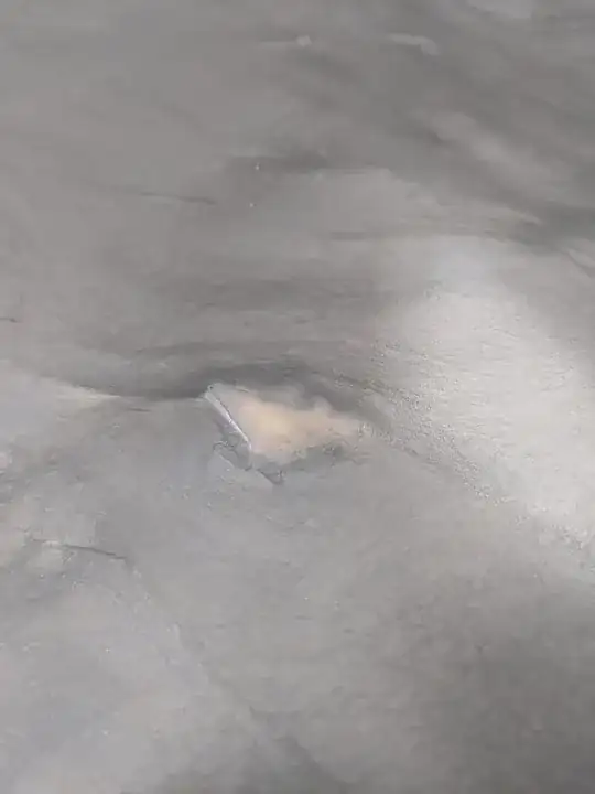

3) There are a few irregular lumps of material. They are small hills and they dont match the level or color of the rest of the epoxy. Maybe some partially cured material got mixed into the epoxy? enter image description here

The epoxy doesn't need to be pool table smooth. Some high spots may need to be sanded a little depending on what type of flooring is going down. If carpet, nothing. Tile nothing. laminate or LVP maybe some light sanding. to remove any ridge or bump over the thickness of a dime.
The look doesn't matter because you are covering it.
