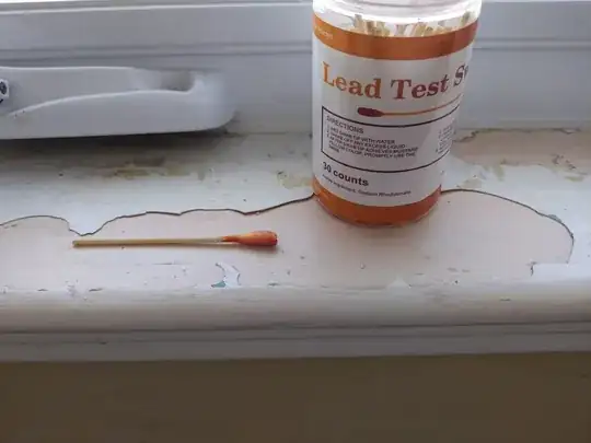

I'm getting my baby's nursery ready and checked a paint layer that got exposed by another layer peeling.
The under layer tested positive for lead and I'd like suggestions as to what to do. My wife called contractors (specialised in lead paint removal) and was told that the job was too small.
Online I read that I shouldn't try to tackle this myself, so what should I do?
I'm worried that covering peeling paint is only a very temporary solution and soon whatever I did over it will peel off. If I go and try to remove the peeling layer and or the lead paint layer I'm worried that I'll contaminate the rest of the room and myself.
What are my safe and decent options?
If it helps I live in Ontario.

Many jurisdictions require training to remove lead paint, even for homeowners working on their own homes. In some jurisdictions you are allowed to do it yourself if it's under a certain amount of square feet, but requires a contractor if it's above the threshold. So check with your jurisdiction.
If you scrape off (not sand off) the peeling paint, apply a good primer and then paint, there's no reason for the paint to peel again, unless there are some underlying issues like the sill getting wet from a leaking window, etc.
Another alternative is to use a chemical paint remover.
You just want to avoid sanding and creating dust that will travel through the house and deposit itself in rugs, carpets, etc., where it can be transferred to children's fingers end eventually to their mouths.
So just get some training, if required, and read about how to safely mitigate your own exposure. I specialize in old houses and every house I work with has lead, asbestos, and black mold. I follow basic safety precautions, and always use a respirators when sanding or grinding, and get my blood levels of lead tested annually. So far it seems that basic precautions are working.

There are numerous lead paint removal services listed in Ontario -- see the results of a quick search on Brave or Google. Try another.
Also, the Government of Canada website has some useful information, such as using a chemical paint stripper paste rather than power tools. However, I'm loath to provide DIY information that impacts the health of you and your family, as a mistake could have serious consequences!

The least risky option is encapsulation. It appears that the top layer (which isn't lead, I take it) is peeling badly which I'm guessing is a lot of your concern. I'd wager that the lead paint is oil, and someone painted over it with latex or acrylic without using a bonding primer designed for that purpose.
If you decide to or need to deal with this yourself, painting is an option. Depending on the state of the rest of that top layer, you might want to carefully peel off the rest of it. Prime it with a good bonding primer and then with a good quality paint. If the rest of that top layer is adhered to the lead paint, you can paint over all of it, but it might not look great unless you smooth out the peeled areas. But that's really just an aesthetic concern.
Whatever you end up doing, do not sand the paint! And if you scrape, don't go wild on it. You want to take it slow, be deliberate and make sure you capture and remove any chips.
