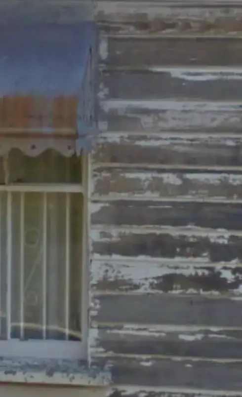

The exterior walls are in a very bad shape, and the whole house needs to be painted.
It looks like this:
queenslander
What equipment should I get to prepare the walls and paint them?

You will need:
  • Carbide scrapers of different sizes
  • Paint spray gun (will save you TONS of time)
  • Several good quality brushes -- edging and flat shapes
  • Wood hardener for any isolated rotted spots of wood
  • Wood filler or bondo to spot-patch rotted areas
  • Extra replacement siding
  • Saw(s) -- circular, oscillating multitool, etc
  • Hammer, nails (galvanized)
  • Aluminum flashing if needed
  • GOOD quality caulk (I like to use Quad, sold at Lowe's)
  • Primer (Zinnser or BIN)
  • Paint
TBH, I've seen siding in much worse shape. DO be concerned about lead exposure if that is lead paint. Some clearer pictures of the worst problem-spots would allow us to give you an idea of other special considerations to take.
