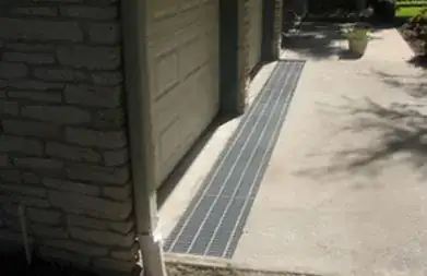

In addition to the other ideas suggested you may want to investigate installing a driveway drain that is a trough cut across the driveway and covered over with a grate. This way any water that comes to near the garage enters the trough and gets shunted to the side of the driveway. The shunted water can then pour into a large french drain or could be diverted to a downslope area.
Here is a picture of what that would look like.

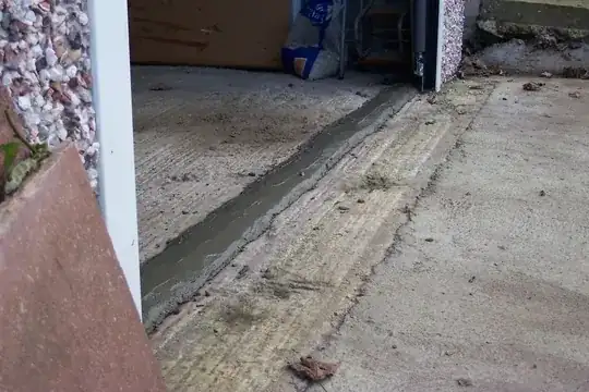

The other option (although quite rough in the example), is a cement hump that will divert the water away from the garage.
Although, in my opinion, I would rather place the hump outside the garage (to divert water), and then make sure that the area directly inside the garage slopes downward to ensure that any water near the garage entrance is sloping away. (ie, the slope where the garage door contacts the floor)
