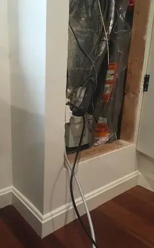

View of the utility closet.

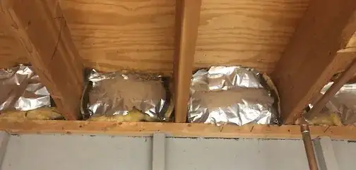

View of the ceiling joists in the opposite corner of the house, an unfinished part of the same basement.

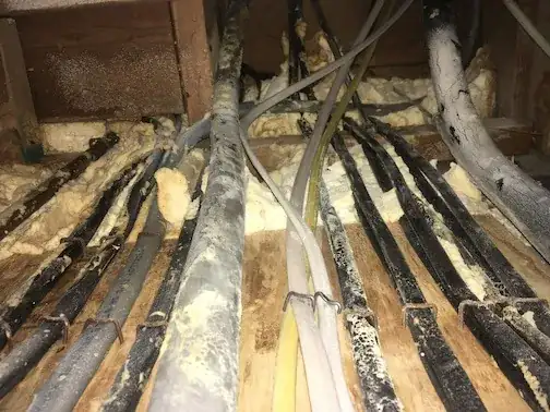

View of the ceiling joists directly above the utility closet.
Approximate location where I would cut to install the grommet. (Actual hole would be smaller than shown.) Most of the hole would be cut out of the stud, with about 1/2" taken from the gap between the stud and the furring.

If the stud in question is the one circled you have in the picture, and it is on the short wall on the left side, My rule of thumb is even on a bearing wall, when studs are that close together, especially at a corner, which is the strongest part of any wall with exceptions, of course, I would not hesitate to remove what is needed to get the part in you needed. The studs are already closer than 16" center to center, which is a code requirement for stud spacing on bearing walls. You are keeping the studs in each corner intact, the one in the center is just filler, in my opinion.
