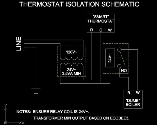

Yes, definitely can be done. My boiler kept rebooting my Ecobee3 (not sure if it was a power spike or drop, concerning either way), so I built an isolation module for it. It isolates both the power and W signal.
Works perfectly now, but I might test all the on-boiler 24V~ components if I have time, just in case the restarting was a symptom of another problem.
The following schematic is basically longneck's instructions with RMan's edit:

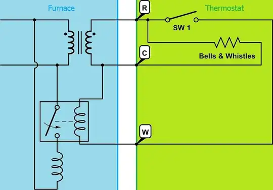

A simplified version of a thermostat schematic, might look something like this...
Thermostat Wiring

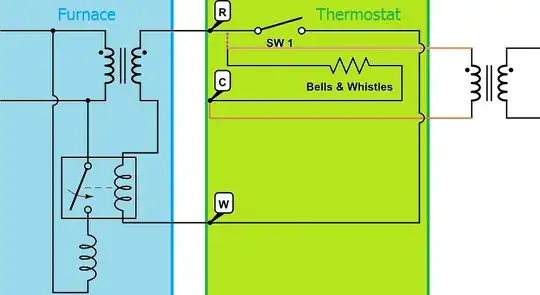

To power the thermostat from an alternate power source, you'd have to modify the circuitry so that the additional features were isolated from the control portion of the thermostat.
Thermostat with alternate power source
