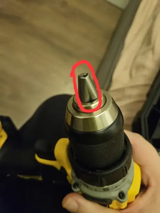

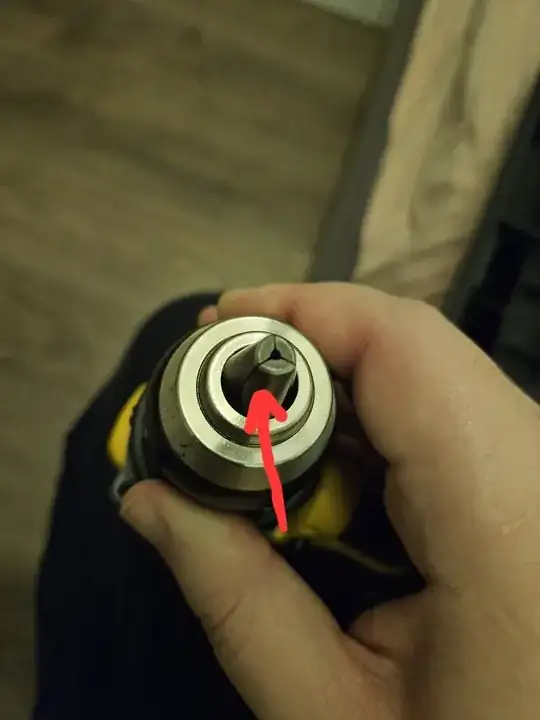

Upon inspection i foud out that the three jaws that hold the bit exhibit some unexpected behavior - while being tightened pre-click the jaws are aligned properly: aligned

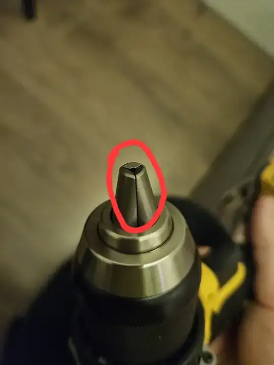

After the click though there is a noticeable gap between two expected contact points: not aligned not alined, gap

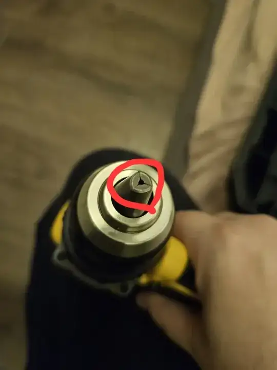

Other jaws align perfectly even when fully tightened past the click: tightly aligned
Is it some kind of a defect that will affect the usage of the drill now/after some use?

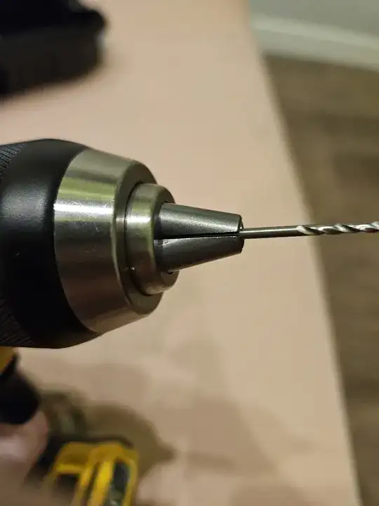

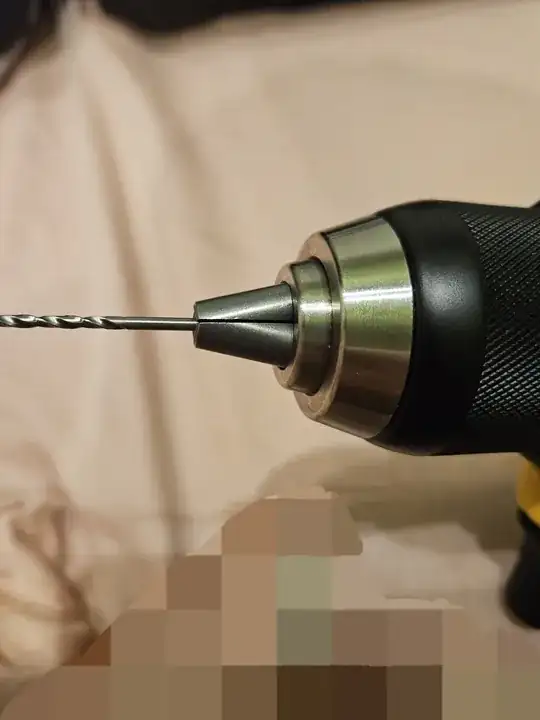

UPD 1: Attaching two more pictures with a 2mm drill bit in the chuck. The first photo is of a side that aligns well, the second is of one that does not aligns better aligns worse

If you're talking about the reverse click, that doesn't tighten anything. It just locks the chuck. It stands to reason that the jaws would shift a bit when there's nothing in it to counteract tightening forces.
I would put a small drill bit in it and see how it spins. That's where the rubber meets the road, as far as I'm concerned. If it doesn't wobble, it's fine.
