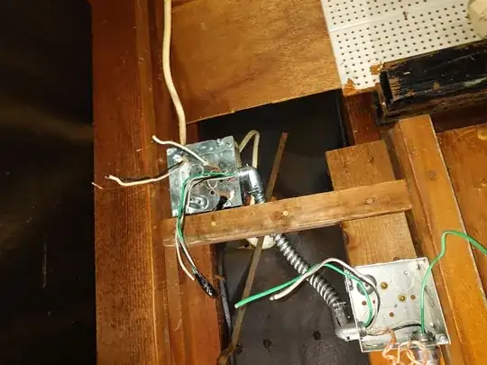

This all was prompted by my recent use of a segment of 1/2 inch FMC with 90-degree squeeze connectors in upgrading the quality of some outlets in unfinished garage wall that will see continuous use at 15A for EV charging. The 90 degree connectors made the 5x 12ga wire pulling quite a pain.
My thought was that FMC looks the same as MC armor and uses the same fittings, so could I just assemble my own wired FMC "whip" to ease a similar setup? I'm only thinking of "standard" MC, not any of the improved/specialty varieties.

Situation that prompted question: enter image description here
