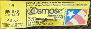

Before buying a post, make sure the label on the pressure treated post says "ground contact" - if it's pressure treated but does not say that, it's useless for in ground use, and will rot anyway. If it says that, you really don't have to do anything to it. If you feel that you simply must do something, coat the ends with roofing patch coating.
Ground contact post label
Concrete is more prone to accelerate decay of a wood post than otherwise - just set it in well packed stone, tamped every few inches as you fill. Use the concrete on something that actually benefits from concrete, or return it to the store.
A post from the same batch as the illustrated label has been my mailbox post for more than 20 years now, just buried in well-tamped dirt - it shows no deterioration.
