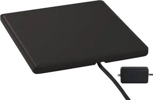

I currently have an RCA Indoor digital flat amplified antenna (ANT1450BR), which doesn't work well.
It seems as though the flap of a butterfly's wings in Brazil, causes my television signal in New York to scramble.
Needless to say, I'm ready for a new antenna. I've been looking at outdoor antennas, but I have no qualms about getting another indoor unit (as long as it works). I'm not looking for product recommendations, rather I'm interested in quantifiable metrics that can be used to compare various antennas.
When shopping for a digital television antenna, what should I be looking at, and how should I compare various makes and models?
